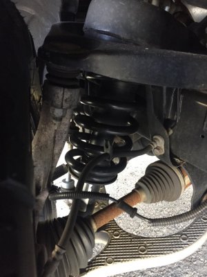

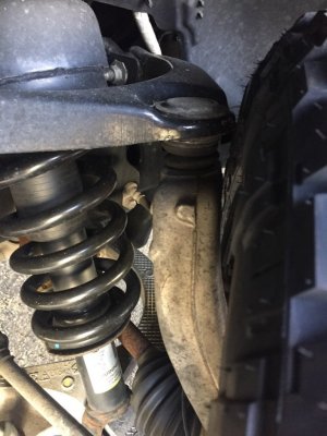

Tried to take some pictures this morning at full lock but I was running late for work so they probably are not great / not what you guys need to tell. IMG_5706.jpg IMG_5705.jpg IMG_5707.jpg IMG_5704.jpg

Do these help at all?

when your are at full lock left do you hear the rubbing on the drivers side or passenger side?
I doesn't look like its rubbing the upper control arm. Could be the sway bar, but also could be rubbing on the fender liner
The driver side, and I have had somebody turn the wheel with me on the outside of the truck while it is parked and it did not hit the fender at all.

my guess is it is rubbing somewhere on the inside edge of the tire toward the cab.
