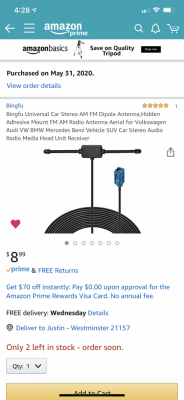

I was able to keep it simple, I found this guy on Amazon. Plugs into the connector under the dash instead of having to go all the way back to the back of the radio. I’m gonna hide it up inside the headliner near the passenger visor, keeping everything inside the cab and completing my antenna relocation for less than $9. Bonus points, now that I will remove my stock antenna completely, I have an unused grommet in the front passenger door jamb I can use to run my new GMRS antenna through. I plugged it in and tested it, I seemingly get the same reception I got
before.
https://www.amazon.com/dp/B07VQS2CTY/ref=cm_sw_r_cp_api_i_3Kv2EbN3DSMF0
before.
Any chance we can see the connector under the dash?
