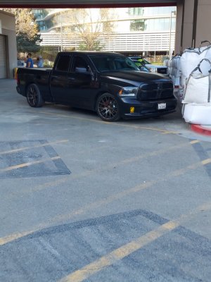

Hey Guys. I want to be able to tuck my wheels, either 24s or 26s. Most preferably 24s. Not sure on what offset is needed. But most importantly after what drop is required to do so. Static not bagged. I don't think I can get away with it with the bolt on ihc 5/7 drop. A little blurry but I attached a picture of what I am referring too. If anyone provides any info I would appreciate it.

Alright guys decided to just go with a simple 4/7 drop, anybody have any pictures they can share? Would prefer 5/8 but I think that would start requiring shock relocation, c notch, and a 3 or 4 link.

Here's my 5/6 drop on 22's. I wouldn't dare try 24 on this drop. Just the 22 I'm having issues with inner fender rubs, loss of turning radius and ride quality.

That looks good! I'm thinking of getting rid of the inner fenders in the front and rear and making or buying some tubs to increase the clearance. I don't want rubber band tires. Does your rear sit higher than the front?

My rear seat higher by 1in when loaded with tools. It's a work truck gave myself that extra clearance for those heaving loads.
Yesterday I actually ran over a parking lot curb. Bent my rim pretty bad. Was able to make it to the rim repair shop with 10psi left on rim. I myself want to get thicker tires now.
