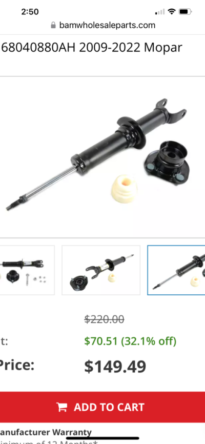

The Bilstein 5100’s come with a spring perch. Ram does sell the springs, spring seat, isolator and top mount separately. While the individual parts aren’t cheap, especially the coil springs, I saw on bamwholesale parts that the are clearing out old stock springs for up to 90 percent off. You could also check with Benny on this site as he works for Mopar parts and may be able to hook you up.

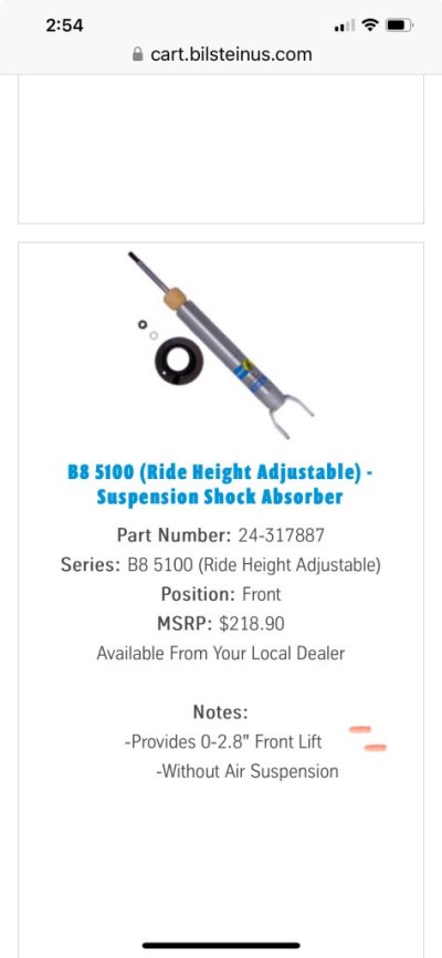

Makes me wonder now also. I purchased mine as a 5100 kit for both front and rear. I have a 2018 4X4 crew cab BigHorn. My OEM struts had the spring perch tack welded onto the strut body so the whole strut cartridge was disposable. My Bilsteins were marked B8 5100 and included the perch which was not welded on and just slipped down over the strut onto the adjustable height locking clip. I looked up my front struts on the Bilstein website and they show the perch as part of the unit that comes in the box. Leads me to wonder if there are specific Bilstein struts for new installs and Bilstein replacement cartridges for previous installs.

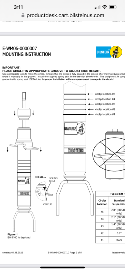

I found the install instructions. The third sentence after IMPORTANT: Place circlip in appropriate grove to adjust ride height, states. Install the supplied spring seat in the direction shown only. Hope the OP gets the correct struts for his truck.
