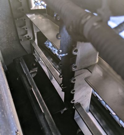

Yeah, not every vehicle came with shutters from the factory. I bought my 2017 new as well, never had shutters. What many vehicles did come with was the frame to install the shutters into. This is behind my grille.

The world may never know.. LOL. I'm not sure that it became standard until 5th Gen, don't know for sure. Obviously from the pic I posted, there was a standard grille which could accept the shutters, but (on mine) there was no connector, motor or wiring. Not only did I buy mine new, but I had ordered it.
