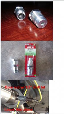

Stack these together. Drill out the top one so the O2 will screw in it. This should work. To keep you from throwing a code. I have been running this setup since I had my Longtubes installed in December. And I haven't thrower a code for my cats since I done this set-up.
