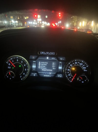

Hey guys, I have a 2019 Dodge Ram with the 3.6l v6. I just woke up one morning to a check engine light. I had a computer hooked up to the obd and it threw a AGS (active grill shutter) code. I pulled everything apart and the AGS along with the whole aero system seemed to be perfectly fine. I can’t really pin point what my issue is. One thing out of the ordinary is my fan is super loud and does not shut off at all after about 10 seconds or so after start up. One thing I realized pertaining to that is if I have the AC on and only at full blast the fan slows down and goes to a normal level. The Truck drives and is perfectly smooth other than the fan and the check engine light. Any help would be greatly appreciated, I’m losing my mind trying to figure this out lol. I’ll literally cash app/venmo/zelle anybody who can help diagnose this, as mechanic shops are filled locally.
Thank you in advance

The AGS operation is monitored, it proves when the shutters are supposed to be open or closed.
As for the fan running, it speed can be driven from the coolant, oil or AC condenser. What temperatures is the EVIC reporting for the oil and coolant?

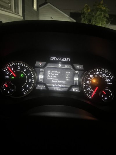

This was from a cold start

CRASH, his temps are fine. Might be a bad sensor or fan relay or a combo of both. OP, U got a code reader capable of reading pending, temporary and perm codes? U need to run a check because U may not always get a MIL light just for codes. OP, I do see that idiotic light so U do need to scan all elements thru OBD, may give U a clue and which direction to go. (Wish my temps looked like OPS).

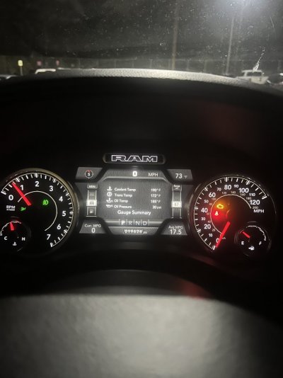

Sorry In advance for the blow up it did not allow me to attach all with description.
This one is about 25minutes from start, no matter how long it stays on past this it doesn’t go any further/warmer. It does feel like the truck warms up very fast compared to regular but it doesn’t go past about half way once it is warmed up. 580779C0-D7F5-4334-AB16-740C62461495.jpeg

Those temps are fine. U need to have a code reader run. Also, in your evic, there is a screen that supposed to show codes (screen message display screen), not sure how reliable why U need to have all codes scanned by a reader.
