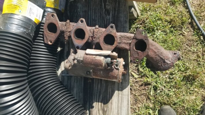

5.4 3V Fords eat passenger side manifolds. They rust between the manifold and stainless layered gasket and pop the rear studs then leak exhaust. It is called rust jacking. I just did one on a 2009 last week and requires atleast unbolting the passenger side mount and jacking the motor up. Ford by the book says to remove the engine.
You can see the layers of scale that popped the studs broken clean off at the rear cylinder. The corrosion also took out the starter by again jacking the starter breaking the flange and bending the other 2 bolts. East coast winters are a killer. I've seen popped rear fasteners on all 3 manufacturers.
