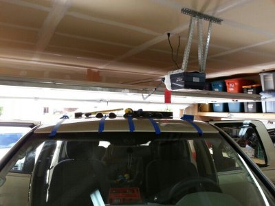

I did mine last summer. No leaks. I added a ton of silicone.uploadfromtaptalk1391752524411.jpguploadfromtaptalk1391752557365.jpguploadfromtaptalk1391752650017.jpguploadfromtaptalk1391752670870.jpguploadfromtaptalk1391752683785.jpg

^ Those look great. I want these, but I cringe at the thought of that many holes in my roof. Sure, it may not leak/rust after the first 2-3 years, but what about year 7?
Thanks!!
It took awhile to get the nerve to drill the first hole. Once the first was done there was no turning back.
As for rust. I put some touch up paint around the hole as well as thread lock on the screws.

Do the Recon's come with a template for the holes or did you have to measure them out on your own?
They come with a template for 3rd generation. You can use it. I just thought the lights looked to far back. So I moved them up almost 2 inches.
Also 3rd generation had a harness on the passenger side. 4th gen do not. I create a wire harness in series. The directions show you how as well.
