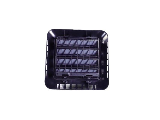

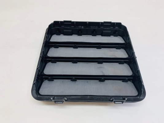

Interesting, It almost appears as though the AB part number (regular 1500 vent) is part of the AA number.
Does the"hooded" portionof the AA (1st pic) go on the inside or outside of the cab?
I'm guessing outside? If so it would definitely stop the rodents and may be the exact reason for the addition of the "hood"
Are these a direct snap in replacement on the 1500's ?
if so would have been nice to Know a week or so ago :pp: :(:happy160:

Hood goes outside . Yes this is what came on my 2014 RCSB from the factory.
I was going to swap with the 1500 style but when I saw the quality of these I decided to keep them.
I removed them through the cab. First popped them out towards the bed ,then kinda twisted them to work them through their hole and into the cab.
Install was reversed.
I have a new pair of the 1500 that I bought, however won’t use them . Free local pickup in west palm beach to anyone interested.

@markabby, in 2019 they changed the design of the cabin vents to a much better design stronger flaps a better rubber seal on all 4 sides of the vent body.
Do they look like the ones in my previous post (#11) or the one pictured here
The ones that had been in my 2015 had a grid of individual square flaps (9 I think) , most of which had fallen off at some point. The replacements I bought were like this with four full-width flaps.
