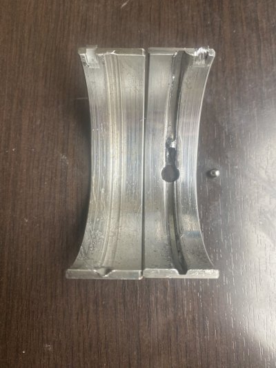

Anyone ever seen this?
2009hemi57
Apr 4, 2026
8
USA
2009
IMG_6312.jpegIMG_6311.jpeg2nd main from the front. Engine was locked up pulled the cap and found this turns freely now it’s like a 3mm steel ball but how would it of gotten there

Oddly coincidental...
Has this engine been rebuilt? Tumbling in steel shot is a common way to clean bare engine blocks before rebuilding these days. It gets into everything and has to be meticulously cleaned out before building.

I just purchased this truck. As far as I know it did not get cleaned only has 127000 miles The person I got it from said ((it was making a loud taping knocking sound. He had done

I got it engine locked couldn’t turn either direction
everything I find while researching says something about a oil Galley plug

As Ken states that engine was rebuilt at one point in time,as there's no steel balls used in a hemi,especially in that size. That ball had to come from the block being tumbled clean and it was lodged in the main bearings oil passage. It couldn't be sucked up from the oil pan as it would've locked up the oil pump,and even if it did make it past the pump,the filter would have caught it,so that ball was farther in,and the only way that would of happened was the engine was in a tumbler tank before being rebuilt,and when the block was cleaned that ball somehow managed to stay in the main bearings oil passage
