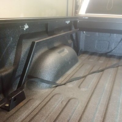

I welded these up for my current truck. They provide 4 solid tie down down low as well as solid rails in the bed to tie to. The skeleton the fender well so they don't really cost any bed space.IMG_20171126_120427.jpg
