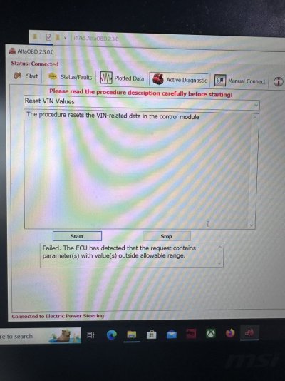

So, anyone used AlphaOBD to program the vin into an EPS?
I noticed that it now has the option to do so, under Ram1500 ∆ 2013+ Power net ∆ Steering ∆ Reset Vin Values?

I'm glad to hear it works.
Let me know if AlphaOBD works for programming the VIN. I'm hoping to avoid the Dealership.

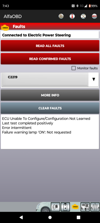

Edit to add:
It had the following error:
I did the left/right lock to lock thing 3 times to relearn the steering angle sensor, and the error went away. So far so good.

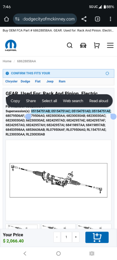

Your "original" rack (r8573449aa) is not your original rack. The r at the beginning of your part# means Remanufactured. Your "dealer" should have known this.
Someone has replaced it before. Rams don't come off the assembly line with rebuilt steering racks.
I get it though. You don't want to risk $3k. You want to know ahead of time that it's a sure thing.
So did i. But, since that wasn't possible, I took the risk.
According to MoparPartsOnline, your original rack was 5154751AE, which has been superceded by updated parts, many, many times since 2013.
There is a long, long chain of this pn# replaced another, replaces another, replaced another, so on.
I'm not sure why those sites now show it as not working with a 2013, because they did back in March 2024.

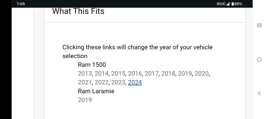

Ok, here... Look at the supercedes part#s.
See, your original rack part# (not the reman#) is there. I highlighted it for you Screenshot_20250907-074602.Chrome.png
Also, the "What This Fits":
And here is the link to where I found this info:

Further, from the same site:
See. Your dealer sucks, just like Rairdon Dodge in Bellingham, WA. We gotta figure **** out on our own, because if i relied on those extra chromosomal twits, our trucks would be in a cube at a landfill.
