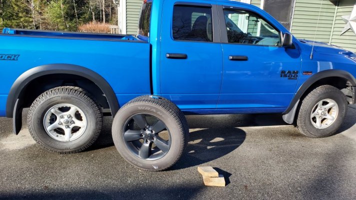

Running 3rd gen stock 17s with 285/70s in the winter. Haven’t had any trouble.20201129_111416_Original.jpeg

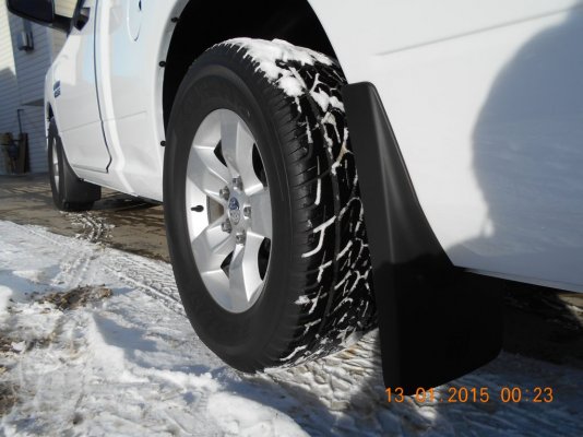

I am wanting to put 285/70's on my OEM 17 inch rims. I just found out that these rims are only 7 inches wide, and 285's require a minimum rim width of 7.5 inches. I really like the look of the rim, and don't want to replace with an aftermarket for only 1/2 inch difference. If anyone has run this set up, I'd like to know if you had any issues ( balancing, rubbing, handling, wear etc).
I ran 285/70's on the factory 17 X 7" rims and liked them. Still have 2 of these rims left over,if you're interested,they're located in Airdrie.
