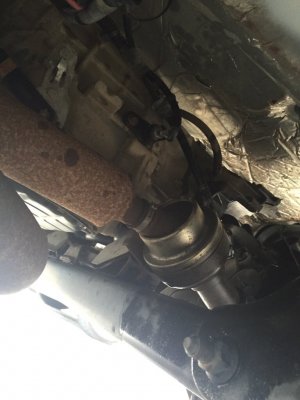

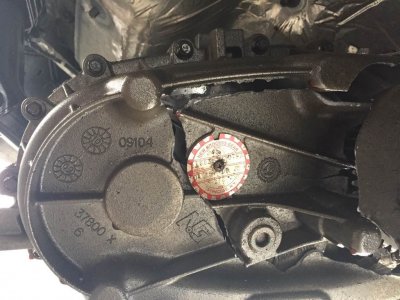

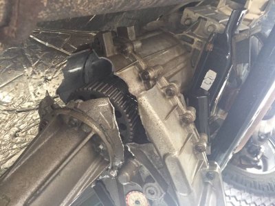

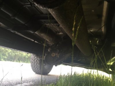

Sooo driving down the interstate passing a 18 wheeler BANG! What was that!? Pull over to the side of the road look under and my driveshaft fell out never to be seen again on the road. I don't even know the cost of repairs nor do I really care at the moment! I'm on vacation worry about that at the end of the week. Here are some pics of the damage. ImageUploadedByTapatalk1433722003.973150.jpgImageUploadedByTapatalk1433722040.041181.jpgImageUploadedByTapatalk1433722056.730457.jpgImageUploadedByTapatalk1433722072.654192.jpgImageUploadedByTapatalk1433722090.079271.jpg

damn! maybe something hit your transfer case? cause that got f'd up!

Honestly we where blessed the driveshaft didn't flip the truck. It fell out going 90 passing a 18 wheeler. T-case is shot to hell not sure if the transmission is affected either. I'm thinking that the rear u joint failed then BOOM the front just exploded. The circle clip where the front u joint bolts up have a slit. Like someone cut the metal!

And that kids is what happens when a U-joint fails at high speed. With that kind of failure, check your fuel tank for damage as well. With the rear joint failing you wouldn't have flipped, had it been the front joint that could have been a different story and why we use driveshaft loops at the drag strip on bigger builds.
