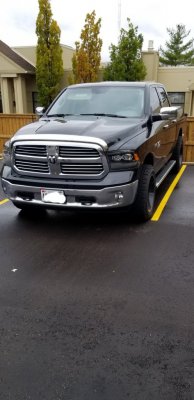

I'm pleased with my G2 headlights. No warning lights, decent output. I have morimoto 35w HIDs with Hylux ballasts for lows and Hikari(?) LEDs for highs. Bought them from a friend who was selling his truck and I cant remember what LEDs he had. Doesnt really matter, I rarely use the high beams anyway53416072a9b4dc63ae0ad0dc2b29e5dd.jpg89a550e0e4f534f32d43945a5323a625.jpg
Nice looking TT.

Nice looking TT.
I know the voices in my head aren’t real, but man, do they ever come up with some great ideas.
Thank you. We only got to use it twice before the snow started to fly. Looking forward to next summer.

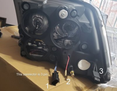

I received these for Christmas. I received the ones shown first from above. I just opened them but now I am working out the wiring. I might be easy once I have them at my truck (2013 Ram 1500). My wife chose to buy the 55W version with 6000K HIDs. The truck is a "before" picture. If anyone has any tips or suggestions on This HID wiring, I would appreciate it!
2nd pic is the drl harness
1- low/high beam connector
2- DRL connector
3- remove bulb from turn signal socket in insert that and place socket like you would on current headlights
4- goes to a ground
5- goes to a keyed on fuse
6/7 connect to the red wire on each headlight (2)
8- positive battery post
9 connects to 14
10 connects to 13
11 connects to 12
15 connects to the blue low beam connector inside the headlights
16 connects to the black low beam connector inside the headlights
