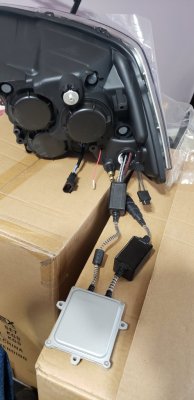

2nd pic is the drl harness
1- low/high beam connector
2- DRL connector
3- remove bulb from turn signal socket in insert that and place socket like you would on current headlights
4- goes to a ground
5- goes to a keyed on fuse
6/7 connect to the red wire on each headlight (2)
8- positive battery post
9 connects to 14
10 connects to 13
11 connects to 12
15 connects to the blue low beam connector inside the headlights
16 connects to the black low beam connector inside the headlights
