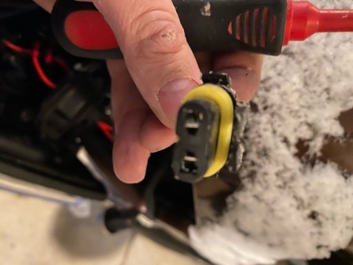

This is what I got , would link to amazon but of course they removed it right after I bought it .
Ah, you got HIDs not LEDs. Does the plug allow you to flip the + and - plugs?
Yea the plug to the bulb itself I can change the positive and negatives , u want me to flip flop the one that isn’t working around other way ?
Yes

Forgot to post this here i originally posted in the alfaobd but should of done it here .
Ok I found the issue , in tracing the wiring found a black wire that was pulled down in the connector housing just enough to not get a good connection
Pushed tight and taped ends . Flickered for a minute when started truck but seems to have stabilized . Hopefully will last but have the other hid coming as a backup . Thanks for all the help
