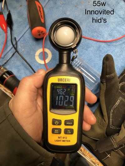

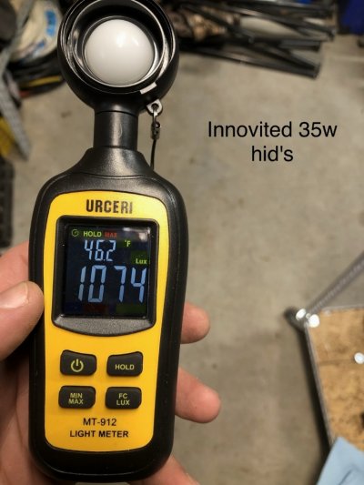

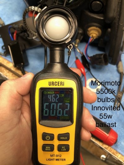

So I was sent the morimoto 35w ballast instead of the 50w (sending them back to get the 50w). Also received the Innovited 55w kit. So I tested the Innovited 55w 6000k, the morimoto 35w 5500k and the Innovited 55w ballast with the morimotos bulbs. I'm really shocked on the outcome. I know my lux meter is cheap and not expecting true readings but still. I didn't get a chance to try the morimoto ballast with the Innovited hid's. I am going to check my battery I'm using to test make sure it's still fully charged.
All H1 bulbs in morimoto H1 7.0 projectors
9f85a957596ae6e4cee63f7025425c0a.jpgb3295c341392eace9fcba125e5031032.jpg4b1ada5366b576288a15fbb941c11848.jpg

Am I seeing this correctly? Are the 55w Innovited not as bright as the 35w?
One thing to remember is that the final color temperature is determined by the pairing of ballast power and the mixture of elements in the HID bulb itself.
The brightest output will be around 5000k. You can take a 6000k 35w kit and add a 55w balasts and the new output temperature will likely be in the 5000k-5500k range. The same should hold true if I start with a 5000k 55w kit and use a 35w ballast instead. The result will be a temperature that is closer to 6000k.
Maybe this can explain some of the descrepancy you see?

The Innovited 55w are the brightest of all, and its not even close.

I must be reading it wrong. Can you tell me what you see? Honest question as I have waffled on just getting the 55w kit but I didn't want to deal with more relays if the factory wiring couldn't handle the load and the ballasts not fitting in the G2's and or being too hot for the interior housing.

You did. I think the Innovited 35w are 5500. I understand that color affects brightness but it shouldn't be that big of a deference between the morimoto 35w and the Innovited 55w or even the Innovited 35w and using the Innovited 55w ballast with the morimoto bulbs shouldn't have that big of a difference. I will say I felt the morimoto set up had more coverage tho

Also I don't know if bulb type/size effects output. The 35w Innovited kit was H7 and what I tested today are H1

So just to be clear the 35w kit did show brighter than the 55w kit when comparing Innovited to Innovited?

Correct. Not by a lot, like 20 lux. I need to make sure that the battery I'm using is still fully charged. I won't be able to test the 35w morimotos again. They are going back tomorrow morning.

Thanks! I'll probably just wait for a failure and up the ballast later then...

What I see:
Morimoto 5500k + innovited 55w - 606.2 lux
Morimoto 35w 5500k - 472.5 lux
55w Innovited HIDs - 1029 lux
Am *I* reading it all wrong?

@SitKneelBend I guess it was closer to 50.
2018 Ram 2500 6.4L Hemi Tradesman
Ahh, I was not referring back to your original pics (or Im missing a pic in the posts)
Hard to comprehend the difference between 600 and 1000 lumens without actually seeing it. It sounds incredible but still not sure I want to bring along the baggage of HID.

Yeah it was a couple of days ago I posted them.
You can see a difference but I think it's more in the color than actual brightness. It wasn't like comparing halogen to hid's. I'd take pic's but it's hard to really capture the difference.
