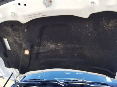

If you decide to take it out, be sure you go on Amazon and get the clips that hold it on. They will break when you take them off.
I had to take mine off recently for a cold air intake hood scoop.
To clean it I simply use a soft brush, worked pretty good
