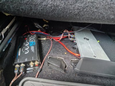

So based on the diagram and pics attached, I assume the speakers are still wired via the factory amp and the input wires into the lc2i are being fed via the factory amp. I assume I'll be able to just disconnect these wires at the factory amp and install the pac amp pro to my new amp along with the new power kit. That sound right to you audio gurus?

if its hooked up like that yes but who knows. whoever did that install in the pics did they use an 8ga power wire? wow i would never trust them with my car
Yes, it was 8 awg, original aftermarket amp was only 300 watt.

First, I would get rid of the 8awg power wiring. That JL XD600 requires 4 gauge power and ground wiring is recommended for installation.
You can actually get rid of the LC2i and replace it with these if you wanted to. JL recommends it, Speaker level inputs via RCA, JL Audio XD-CLRAIC2-SW required.
https://www.sonicelectronix.com/item_45960_JL-Audio-Speaker-Wire-to-RCA-Cable-XD-CLRAIC2-SW.html
Then set your gains properly and you should be good.
Even when you had the XD300 installed, the installer should have ran 4awg as it is recommended by JL.

OH, I see you went with the PAC unit!! Good choice! Remove the LC2I completely from the truck. You can use the PAC to send signal to just the subs if you want, using the factory amp to power the door and dash speakers. http://www.ramforum.com/f51/2015_alpine_sucks_changed_everything_but_hu-105477/index3.html if you decide later you want to amp the doors and dash the preouts are there for that too!
So I tried tracing the wires to the lc2i and it doesn't look like it's connected to the factory amp. I tried unplugging the lc2i and the speakers worked perfectly fine. Guess I'll run the pac to just the sub?

I just plugged it in and set my amp crossovers, I set gain with multi-meter then ran a 40hz tone and went up until distortion to dial it in.
If you unpluged the LC2I and all the dash and door speakers worked they were just using the lc2I to send signal to the sub amp, which is normal for that application.
The PAC unit has rca outs for highs mids and lows, once installed just plug in your RCAs to the lows output and run that to your amp. Pay attention to the port tune on your box and tune the SSF to about a half an octave below that. if you are using the fox acoustics box for 10s, the port is at 35hz I tuned mine to 25hz and all is good. The signal from the PAC unit is a true full range signal so the filters must be set correctly at the amp. Our trucks mid bass starts at around 80hz and goes on up from there, I set my low pass at 100 and it sounds pretty good right there. As for setting gains, Just youtube " how to set gains using a multimeter" thats your best bet to not fry another sub. I can tell you I am running two sundown SA10s on a SCV 2000w amp in a fox acoustics box its loud but not flex your windshield loud you need a bigger box for that. If I had it to do over again Id buy the 12s box and put 10s in it.
The good thing about the PAC is you can amp the door speakers when youre ready and the RCAs are already there so its as easy as just plugging in your rca cables and running them to your amp. No summing of wires, splicing after the amp, tracking down which wires go where to what and then the gain hiss.... ahhhhh it didnt matter what you did high end DSP or audiocontrol or whatever else the gain hiss was so prominent it would drive me insane. NO MORE with the pac unit its super quiet now!! Until Im ready for it to get loud!!
