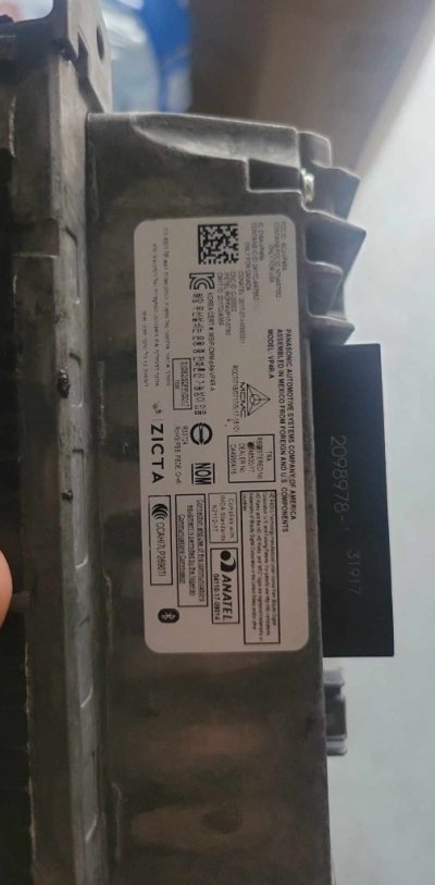

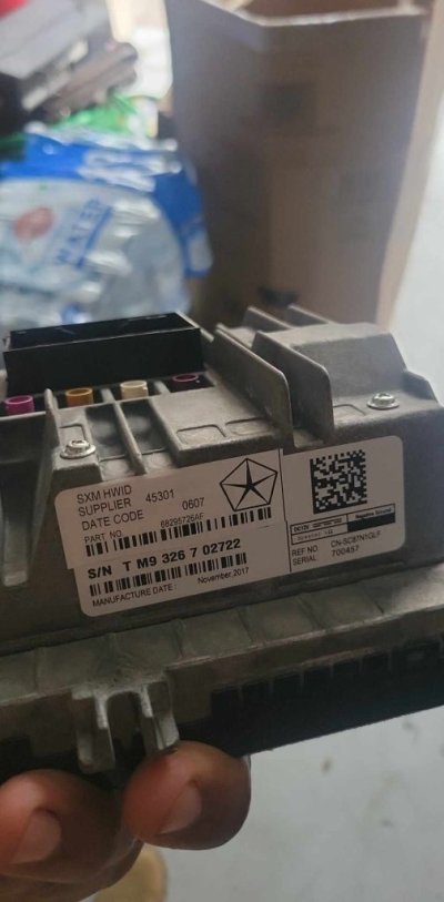

I have the opportunity to purchase a 2018 head unit with AA and Android Auto. After searching the site the part #68295726AF didn't showup on the list of head units with AA/Apple Carplay. I have a 2016 RAM 1500 L1000006727.jpg1000006728.jpgaramie. I don't want to get scammed.

I have the opportunity to purchase a 2018 head unit with AA and Android Auto. After searching the site the part #68295726AF didn't showup on the list of head units with AA/Apple Carplay. I have a 2016 RAM 1500 LView attachment 550462View attachment 550463aramie. I don't want to get scammed.
It looks strange, almost like a prototype or tech sample?

The guys said it was installed in his 2014 Ram and it worked flawlessly.
This is not to say it wouldn't work but only that it looks strange.
