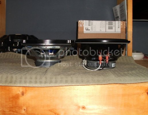

here is a pic of both units, easy to see how much of a difference there is
Not sure how much difference it makes you can turn the tweeters to point in specific positions so regardless of install being horizontal or vertical you can point the tweeter towards the ear level, Not sure if it makes a difference, but pretty cool none the less. You can really see the difference in this pic

Got the fronts in tonight , the bar behind the front speakers is problematic to sat the least, I could have easily just screwed these in, but was not comfortable with the magnet resting against the steel bar as I did not want to risk having a vibration. I can say removing the door panels has become easy once you get the procedure down.
In this picture you can see the depth difference, turns out the little bit makes all the difference
I bought some 1/8" and 1/4" nylon spacers the other day just in case, good thing I did. The 1/4" worked perfect. and do not touch the door panels at all and easily clears the metal bar behind the speaker.
