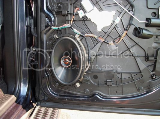

Got both sets of Infinity REF-9622IX 6x9 2 way speakers delivered yesterday
Had some time tonight to get the rear speakers installed. First door took about an hour and 10 minutes and I lost one of the metal clips off the plastic upright and it fell into the door .... :(
Now wondering if I will have a rattle forever as I could not retrieve it, easy enough to grab one form the dealer, just hoping it does not rattle.
After the first door was done the second door took 12 minutes & I did not lose the metal clip....
Experience is everything :)
Playing the same demo song that I used on the fronts (Don't Cha)
Wow, what a difference it seem to expand the sound stage on the high and low end, as well as not coming across as muddy, thye definition is night and day from the stock units.
here is a pic of both units, easy to see how much of a difference there is
Not sure how much difference it makes you can turn the tweeters to point in specific positions so regardless of install being horizontal or vertical you can point the tweeter towards the ear level, Not sure if it makes a difference, but pretty cool none the less. You can really see the difference in this pic
If nothing pops up I hope to install the fronts tomorrow and see how the depth of these work out
Here is one of the speaker installed
Did a complete listen start to end and if I gain as much low end as I did in the rear I think I may be happy with the system with out a amp and larger sub solution

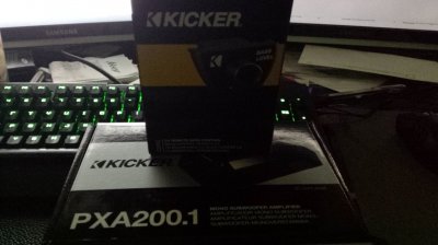

My roomie picked up a physically small kicker amp/10" sub and box..I think he said it was around 200 watts..Seems its strong enough to run 10 subs...I dont know the details an all(he is haveing a nap)so i cant ask but from what he says its kicks hard from his factory ford pickup audio system..Oh and he tells me its amp setting are good from 1 ohm to 8 i think..
This might be an option for the alpine set up as well..Ill have to get more details..
craigsez
Aug 24, 2012
1,081
396
Novascotia,Canada
amp
Found the amp..Wonder if its basically plug n play...Seems to have an auto senceing pick up so that you dont need the extra switching wire..plus a bigger sub..
