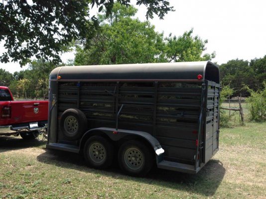

Honestly, neva tried. Out getting hay and loading all by myself (into an enclosed stock trailer), neva turned off till got home, backed up trailer to garage to unload, then shut down. Truck only shut down if getting hay from a feed store, since their workers load, as opposed to getting hay out of the field where I be the driver, loader, unloader, man wears me out, think not as young as I used to be.
