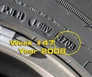

Also if you do not know how to check your tires date code here is a tire showing you what the four digit date looks like first two is week # and second two year
