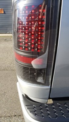

Yeah, don't buy from these guys. I spent over two hundred bucks and two months later the lights are filling in with water. Just got an email basically saying I'm screwed. The driver's side also is filled with water.Vipmotoz crap.jpg

Not to sound like an ass but this is another classic you get what you pay for.... But I mean Atleast you did get the product lol

Would adding a bead of clear silicone around aftermarket lights help?

I would take these lights out, shake out the water, run a bead of clear silicone around all the edges where there’s a connection then take gorilla tape and tape the silicone seals, make certain you can’t see the tape once installed. I do this with every pair of lights I buy, even the OEM ones, never had water get in again, $200 is $200 to me.
