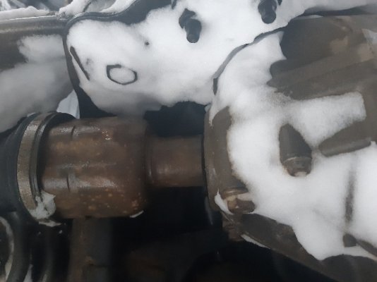

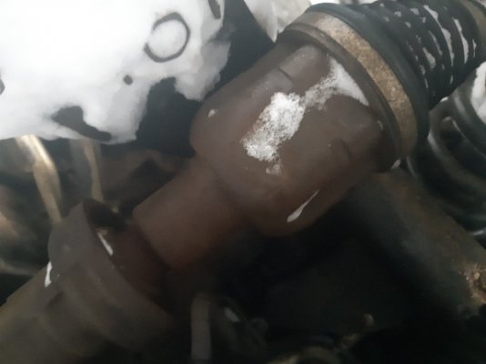

Here's the pics of my rig. Sorry it's absolutely packed with snow.
Top pic is driver bottom is passenger 972877f58b846fc110244b55f58a1233.jpga9a0c636551e5fc701df1b5d8104f02b.jpg

So that’s like mine. It’s further away on passenger side and right up almost to seal on driver side. Man thanks for that, I guess I could have peered under someone’s truck parked here but you know how it is now days!

Not a problem. Sorry for the delay.
