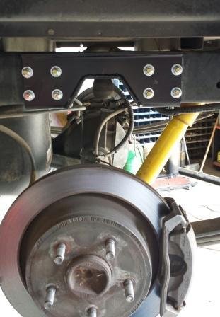

More than a few tow with the bolt in notch kits. I have a 3/8" plate welded on the back that even makes it stronger than just the original kit. That section of the frame is stronger than the rest of the frame IMO.
This is just bolted in. Before being fully welded.
I'm not encouraging you to cut on your truck, but don't think it is a weak spot.

Not trying To Start A Argument but Yes That Does Make Frame Weaker Than Stock Just To Make A Point Take A Say a 2x4 Is 24 Inchs Long now take a 2x2 24inchs long now both laying across a brick standing up one under each end now hit both with a 8lbs Sledge Hammer Which One You Think Will Break The 2x2 Because it Half The Height of the 2x4 same with the frame rail you have a 2x4 with a 2x2 right in the middle of the span which makes that a weak spot anyway iv got a gooseneck hidden hitch mounted to my frame right there so I cant do that anyway but point being its a weak spot

You make an excellent point except the frame is not solid and the notch kit is made of thicker plate then the OEM frame material plus I added a fully welded in 3/8" back plate to box the inside of the notch kit. Unfortunately our frames material is not that thick and relies on being boxed rather than metal strength. But with that said I don't recommend anyone cutting their frame and thinking it is better in anyway other than to provide axle clearance. The added back plate I made I think should be offered with the kit, but then it wouldn't be a bolt-in kit any longer. The bottom line is if you drop more than 4-1/2" you will need additional clearance of a notch.. Good luck with whatever folks choose.

True Being boxed in does help
