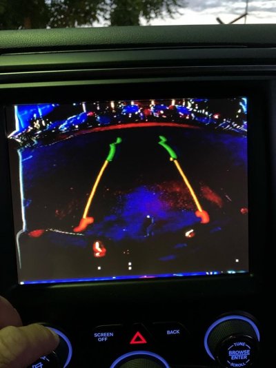

When I put my truck in reverse, camera was good, all of a sudden it got all distorted. See pic below.
While driving, I’d turn my camera on and it would get worse and worse. Then all of a sudden, it’s good again.
This last few weeks, I hauled a scoop of gravel, a lot of dust/dirt when unloading. This weekend, remodeling my bathroom, hauled the trash to the dump. Again a lot of dirt/ debris. Could dust get into the connectors? The screen is good. While it was distorted, the check surrounding warning was clear as day, seems like just the video feed was bad.
Any ideas? Thanks in advance. Also, my bumper to bumper warranty ended two months ago. Thanks in advance. d226b2759d9f686dc179ca60bce0be14.jpg

Pull the connection at the tailgate apart and make sure it's clean. Reconnect and make sure the connection is tight

i tried to pull the connector off but wouldn’t budge. I couldn’t figure out how because I couldn’t figure out if the two white strips were tabs or not. Didn’t want to break it.

I had the same problem-I read that if you open and slam the tailgate shut it may fix it- I slammed it shut and yes it fixed the problem- worth a try- if not disconnect the battery negative cable for 30 seconds and reconnect-

Mine has done this from time to time ever since I had the dealership perform the recall for the tailgate opening. The most recent time it happened I was in my driveway and when I threw it is reverse my back-up camera looked exactly like yours, but when I back out of my driveway and hit the lip of my driveway to the street it when back to the normal image. I assume that I either have a loose connection or some corrosion on the inside of the connector. Luckily I am still covered under my 3/36,000 warranty so I just made an appointment to get it looked at. If I wasn't I would be opening up the tailgate and inspecting the connectors to the camera itself and also the wire going into the tailgate from the bed to make sure nothing was pinched or chaffed.
