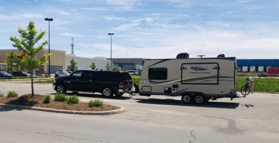

I am a similar boat 2018 Laramie 1500 with 1000 airlift airbags. My trailer is 21 foot hybrid and leer cap. Towing it to Florida two marched ago. Not a issue.
just so tired of the tow police. On this and other sites.
