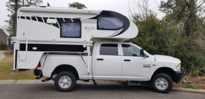

I’ve been doing too much thinking about going back to a half ton. I found a 2021 warlock classic with big horn interior, crew cab, 5.7 and 3.92 gears. I don’t know specific payload yet. I want it I miss my 2017 ram 1500 big horn.
Currently I have a 2018 2500 tradesman crew cab with a 6.4 and 3.73 gears. I bought this strictly to pull my 2020 imagine 3000qb it’s 35.5 feet bumper to hitch 30 foot box. Weights between 8k and 8300 loaded depending on the trip.
Question is, am I going to hate towing my camper with this warlock? I’d definitely put some airlift 1000 bags in it so firm up the rear end when towing. I towed a smaller camper with my last ram and it did very well. I don’t care if gets 5 mpg towing i just miss getting 20+ most of the other times I use it, and the smooth ride.
I’d just like some real world experiences. I know all about payloads and proper loading yada yada. I know that’s something I’d need to contend with if I did it.
Im just the opposite. I will never go back to a 1500 from my 2500 which is the same as yours. Payload is everything to me.

While I agree the, "weight police" are largely ridiculous on message boards, this part of your post is just plain ignorant. "Get what you want.... you only live once." Yeah, with a mindset like that it won't be for that long.
Probably runs 85 mph also because the truck can do it. I have learned very quickly since becoming interested in truck campers about proper setups and ratings.
