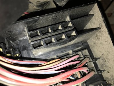

I feel betrayed, yesterday y took a picture from the back part of the fuse box only to find out there is no clamps or wires connected to anything, how is this posible?
is it posible that the truck came out without the buzzer option?
here is a picture, maybe you can give more info regarding this.

looks like you have one of them trucks that got the mexican twist or maybe they changed something in 96. i really don't know what to say. i am guessing they may they just didn't use them just like your truck has TBI instead of the MPFI that is used on all the other 93 and newer rams made for the north american market.
