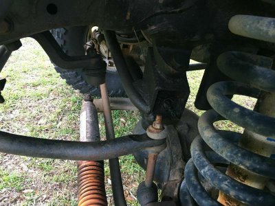

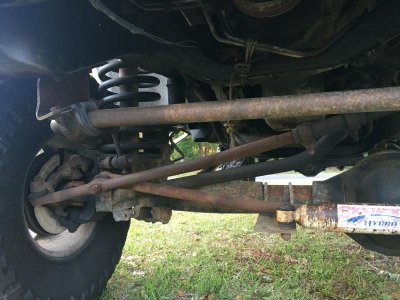

Hello all,
I recently bought (cheap) a 1999 Ram 1500 4x4 5.9L I have questions about the current lift that is on it. It doesn't handle too well and have thought about just buying a new lift and having a professional install it. Has 37s and probably will go with 35s afterwards to help with drive ability...not really going to be an off-road rig, just on occasion. Anyhow, just want someone to look at what is currently on it and give me their opinion on what is currently on there. I have read that stacking blocks is bad, looks like that is what i have on the back....Not sure what is going on with the front, it looks like a mess. Looks like some sort of home-made bracket was welded to the frame. Is there anything reasonable I can do to fix the lift that is on here, or is it too bad and I need to start over...thanks for any suggestions...
DodgeDude99
Aug 16, 2016
594
283
Oak Lawn, Illinois
That’s a Skyjacker track bar drop bracket. The track bar is probably shot.
It’s an obviously piece together lift somehow. That truck looks familiar, I remember seeing it with Ground Hawg tires years ago on PavementSucks.
That’s some sorts of long arm kit, maybe a Fabtech or **** Cepek.
The double stack blocks have got to go.
If it were me, I would ditch the inverted Y steering linkage for the inverted T off the ‘02 2500’s ( it will bolt right in).
Replace the shocks, ball joints, hub bearings, source an aftermarket style track bar, & at least an add a leaf for the rear.
The steering stabilizer is a band aid for anything and not needed. I didn’t run one my ‘99 Ram w/37”s not my K5 w/40”s with no issues. If the chassis parts are tight & good quality you don’t need it.
Gr8bawana
Dec 7, 2015
1,391
1,262
6.7 CTD
Talk about a hack job! :superhack: I especially like the rope holding who knows what.
I think you should just start over with a new correct lift kit and have it done professionally if you don't have the tools and know-how.

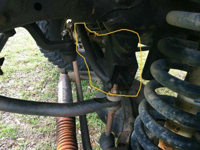

Kind of what I was thinking, starting over...Looks like the rope is holding the tranny lines out of the way...what is the thing highlighted in the attached picture? Looks like it was homemade and welded onIMG_6900-800x600-800x600.JPG
Gr8bawana
Dec 7, 2015
1,391
1,262
6.7 CTD
Can't tell what that is. That crappy exhaust needs to go as well. I also see more rope on the front end, holy ****!

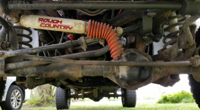

Hi, new to the forum here...Similar question...can anyone identify this lift? Rides fine but looks crappy. Was thinking of putting the Rough Country dual front stabilizer set up on the front but don't know if it will fit. Any help is appreciated (1996 1500 4x4)
dodge dude94
Millennial Boomer
Sep 5, 2013
27,745
6,429
East Texas
1998 Ram 1500
5.9 Magnum
Honestly looks like an old Skyjacker or Rough Country lift that has seen better days.
ouch1011
Dec 3, 2017
58
12
1996
Magnum 5.2
With the angle on the steering drag link, it's never going to handle well. There will always be awful bump steer. Needs a drop pitman arm.
