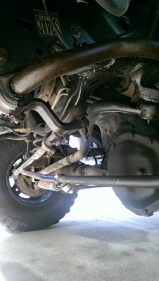

Here are some pictures just to give you an idea of what I'm dealing with. It not very good looking. I didn't snap any pictures of the ball joints because you couldn't really tell just from a picture. What do you guys think?

The ball joints don't look torn up to me. That's weird. Track bar ball looks buggered and so do the tie rods though.

Yeah it was weird cause when I wiggled the tire the ball joints seemed fine but when the shop did it they moved a little. Idk whats up lol

You're supposed to put a pry bar to it to check for play in ball joints.
