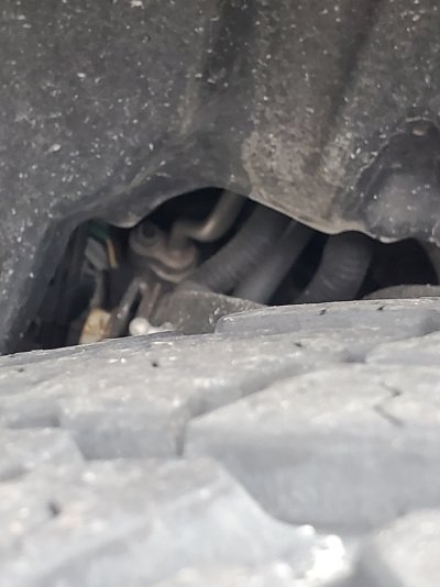

Okay. Rotated the tires and still noisy. So I took a look at the threads again today and noticed every other piece of thread is higher then the other. What might cause that and if this might be the problem.919c93fba599cff78a43c5e40ec0eb0d.jpgd2c81cda74d142ac20d5dd321cccbe42.jpg

That kind of tire wear is indicative of a lack of tire rotation. Should be moving them around every 5,000 miles. It'll take a month or so but they'll quiet down once they can wear even again. If you get extreme bar wear on a tire, check the shocks. The combination of a bad shock and And out of balance tire can be devastating to tire tread.

I noticed this is happening on both front tires only. Should I put them both in the back then? Can too much air in tires cause this? I always fill my tire with more pressure then recommended per sticker on the door but less then max pressure per info on tire. I just don't like the low pressure warning to show every time it's cold outside.
