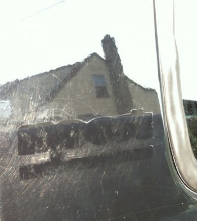

Ok so HELP! Do I need to repair my door now! I live the way it looks with no RAM1500 but look at my door! What do I do? ImageUploadedByTapatalk1335849868.299988.jpgafter scrubbing and scrubbing to try and get the glue/ 3m tape off the door is all dull and you can still see the badging leftovers...

Ok so HELP! Do I need to repair my door now! I live the way it looks with no RAM1500 but look at my door! What do I do? View attachment 4980after scrubbing and scrubbing to try and get the glue/ 3m tape off the door is all dull and you can still see the badging leftovers...
Same problem happend to me just get some Googone and a terri cloth and some warms dish soap and water and you may have ghost lettering after but once a nice wax it will be gone
