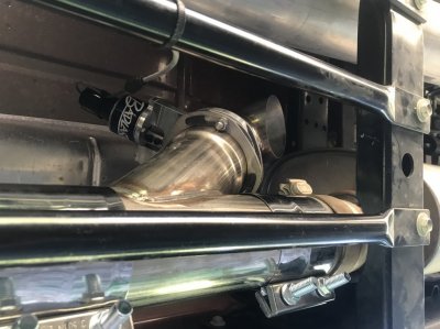

In my life I have always been a fan of fast and loud. My Pdub is just too good of a comfortable, family carrying, good stereo having vehicle to be putting a normal loud exhaust on. So I got the loud mouth button for when I’m feeling rowdy, or I encounter one of those silly Raptors. It’s really loud, and it’s really quiet.

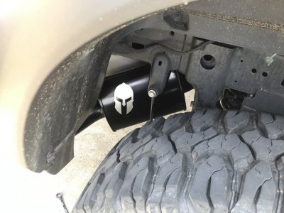

As far as install, the skid plate in the area is a bit in the way but I was able to make it work. I got the optional turn down which In my case is pointed more backwards than down due to the before mentioned skid plate. I highly recommend picking one up.

I forgot to mention that I did a paint job on the resonator and added a sweet tip. It definitely got rid of the grandpa look of the factory exhaust.

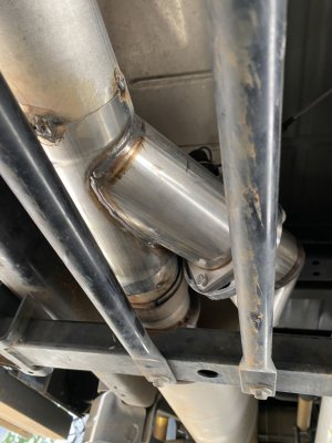

Okay @ZLAYER I ordered this last night. SS 3.5 in with down pipe. Finish your write up as promised. Lol. We want to see more details on the wires and cutting. The skid plate had to be removed for install I assume?

Nope, I didn’t remove the skid plate. Instead of having the y pipe going straight to the side like most are done, I clocked it up a bit more so and attached the turn down so that it fires the exhaust down and back between the factory muffler and the drive shaft. That way I was able to clear the skid plate.

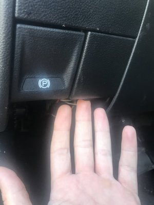

for wiring I ran a wire through a rubber grommet in the firewall and to the battery. I placed the switch on the factory knockout spot that’s next to the hood release. I put the switch on the underside so it can’t be seen. There was a little dremeling involved to make that work.

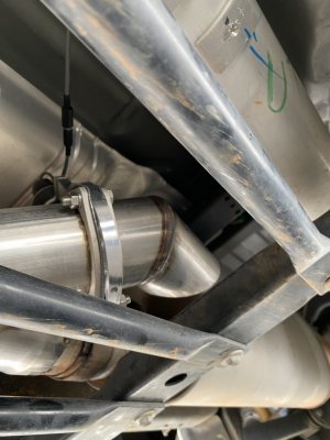

I got my kit in yesterday and realized I did not order the clamps. I emailed the seller if I missed something or should I just weld it and he said “Yes. Very easy” so fortunately I can weld and own a rig, though the OP used clamps I’m on the fence.

You can buy his clamps, or they have them on Amazon, or eBay. Welding would be a more permanent solution obviously though (although more work).

I have it tacked in for now to see it I want to rotate it a little more down before a do a full weld. I see what you mean about “rowdy” holy cow! The truck goes from a sleeper to a helcat in about 4sec! Crazy muscle car sound. All with the flip of a switch. Crazy fun mod!
