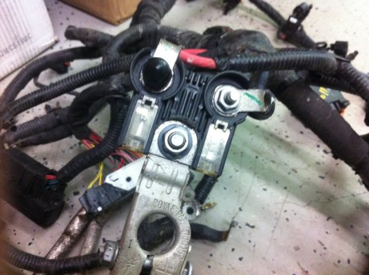

Check the cable that feeds over to the fuse box,if it's gone to hell,the truck isn't going to start. Take a booster cable and hook it up to the positive on the battery and then hook the other end to the 13mm bolt at the fuse box and see if anything changes.You could also have issues with the connectors under the fuse box

Check the cable that feeds over to the fuse box,if it's gone to hell,the truck isn't going to start. Take a booster cable and hook it up to the positive on the battery and then hook the other end to the 13mm bolt at the fuse box and see it anything changes.You could also have issues with the connectors under the fuse box
Will do, thank you.
