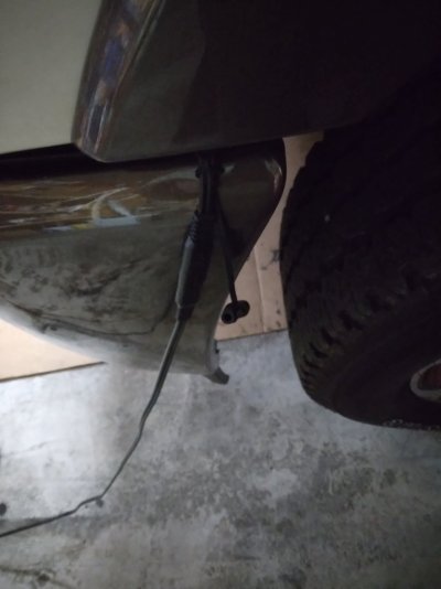

Also please dont use any battery tenders made by harbor freight! Run your connection externally, and your hood aarm isnt a factor.
Are there any specific battery tenders that you have concerns about?
AFAIK, Harbour Freight is a distributor and does not manufacture anything.
