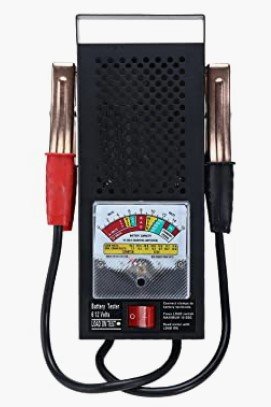

I'm going to guess the battery load test was performed using a digital battery load tester. They're just not reliable enough period.
Get an analogue toaster-style battery load tester from HarbourFreight for $20 and prove the battery before wasting any more time and money with a parts canon.
If you have a flakey cell, it could cause havoc with your truck and most likely not show up on a digital battery load tester.
Until this test is performed, the battery is still the prime suspect, persuing anything else at this juncture is wasting time and money. We see a constant flow of users playing this game, over and over again.
Also, make sure that the battery posts & clamps are clean and tight. While you're at HarbourFreight, snag a $3 battery post/clamp cleaner too.
Also, make sure that the battery posts & clamps are clean and tight. While you're at HarbourFreight, snag a battery post/clamp cleaner too.
And, View attachment 546811 to Ram Forum. :cool:
I got a digital tester and a multi-meter, and also bought the old Toaster Style analog, and outta the 3, the Toaster is the best. Just beware, when U hit test battery under load, the load comes from a "heating" coil inside the toaster unit, and do not go beyond recommended test of 10 seconds, as the coil get "pretty" warm.
RamDriver is correct. Confirm on battery before firing the proverbial parts cannon, as a bad battery cause those issues, and needs to be tested properly. Alternator putting out 14 Volts OK, usually be more around 14.2/3 after sitting a while and even a bit more till system gets "SOC" back to norms.
