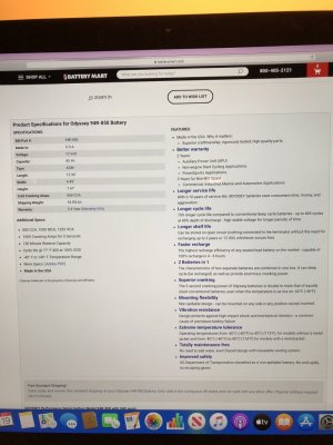

I went through that a couple weeks ago with autozone doing all the checking Eventually I could not start the truck with a charger. I bought an ODYSSEY 850 94R I think the numbers are . It cranks 1500ca for the first 5 seconds. Its pretty much the brand most otherd are compared to . Autozone seems to have the best price but they have to order it . My friend laughed as he said he never saw a battery come with an owners manual . I have never had to replace one yet
