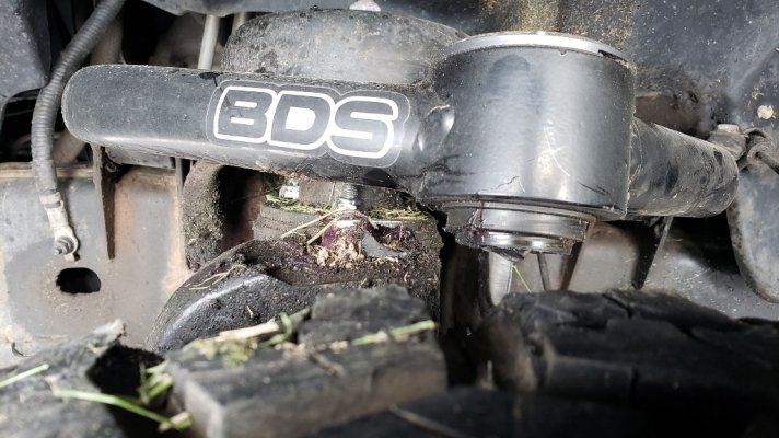

No signs of BDS in this thread in the 5th gen forums, but they have been notified.

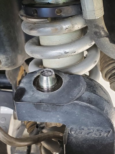

1st occurrence Jan 03/2021
In the 1st case below, they only honored the UCA's. $1800 of damage because the BDS UCA BJ snapped. Everybody thought it was an isolated ocurrence.
Jan 03,2021
FISHON:
"Not romping it hard, literally flipped a U turn in a rutted dirt lot and got the *** end a little loose. Then she stopped moving... Ball joint blew, which let the spindle fall, which let the CV shear/snap, which railed the lower ball joints, tie rod ends, sway bar links, etc...
Calling BDS in the morning to see what the warranty will cover as far as the "ripple effect" of damage."
Then Jan 13
RAMROB91:
same here my BJ broke going threw some small puddles super pissed for the amount of money I paid for them
If anybody wants a link to the thread PM me and i'll sent it to you.
These are the same BDS UCA's you get for the 2-3" lift, part# 122251
I thought these type of UCA's couldn't be used in 6" lifts cause they should have an offset, though BDS say they can be used in their 6" lift, but not the 4" one. I believe a bad batch of BJ's maybe at fault in both instances but given the gap between both ocurrences it may be a good idea to hold on buying these UCA's until BDS can address the issue. it's bizarre they haven't posted a single word about this in the other forum.
I do hope BDS own this right away, so far they're just sending out replacement BJ's. i'd like to see some sort of root cause analysis so everybody knows what happened. So much for a "warranty" but it's what it's when we mod our babies. you gotta pay to play and this is the worst case scenario when we pay to play.

To clarify none of them are my trucks. Just helping out a fellow enthusiast. In this case we have two with the same issue in literally 2 weeks.
Quick_Shifter
IG: @ak_trucks_pa
TOTY Winner
Aug 14, 2018
4,343
4,347
ASTON,PA
AK Trucks Tuned 5.7
Wow, That’s a clean break too.

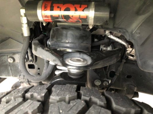

I recently had the BDS 6" Coilover lift installed on my truck, but opted to re-use my OEM UCAs, since at 6" there shouldn't be a need for any extra UCA offset.

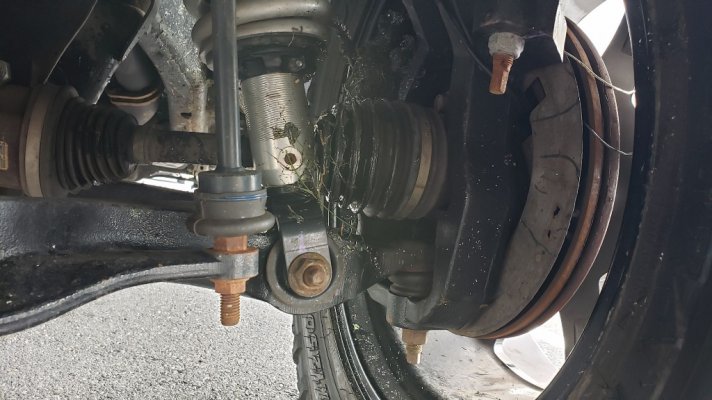

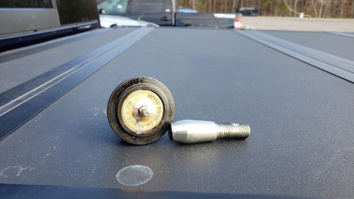

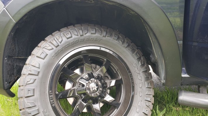

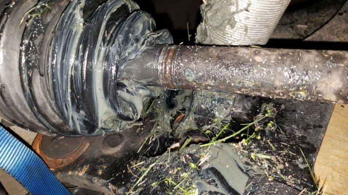

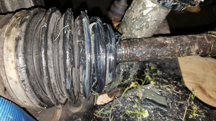

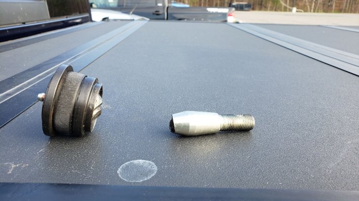

Unfortunately this happened to me Sunday. Approximately 2000 miles and zero offroad on my BDS control arms.
State trooper told me there was at least 300 feet of skid mark about 2 feet away from the guard rail...yep...I was there for that.
I sent all these photos to BDS. Their tech support tells me their control arms are not recommended for their 4" lift kits. Not the same thing the sales person told me when I was convinced to buy them. Bottom line I am paying out of pocket to replace the tire, cv axle, abs sensor, tie rod end, sway bar end link, and possibly a lower ball joint. Tech support was only willing to cover their parts so I'm being sent more crappy Moog "Problem Causer" ball joints.
I was told using the Fox 2.0 coilover shocks with the 4" lift and it's required spacers has not been tested by them so they wouldn't accept liability for their product failure. No Fine Print warranty my ass! He told me their 4" lift kit is based on using stock struts. I asked what's the difference since the fox shocks were set to factory height per the instructions and going back to factory struts I'd still have the same height issues and angles on the control arms. No response. The shop that did my install is just as shocked by BDS and their response. My shop recommended we raise the front an inch to decrease the angle of the control arms and go to 3 inch spacers in the rear to keep it level. After seeing how others of you out there have the 6" lift and suffered the same failure you'd think BDS would realize there's a serious problem with the ball joints they are using!
It's very aggravating that BDS won't step up for their product failure and how this could have been a far worse situation...potentially life ending! Of course my setup was going to work fine when I was convinced to make the purchase of their control arms, but now that something has seriously gone wrong they are back tracking with quickness. Say anything to make the sale...then find any reason not to honor up to collateral damage cause by a failure of their parts.
Shout out to the tow driver that got me from Gettysburg to Dillsburg where I was able to get the replacement ball joint and to the AAA tow driver that got me all the way back to WB. I was able to get the ball joint replaced Sunday night and had to order a new abs sensor from Amazon since it wasn't available locally at 1/8 the price. My shop got the new tire in this afternoon along with the replacement cv shaft so I'm setting up to bring it to them Thursday morning.
If anyone has recommendations of control arms that I can trust...please share. Worried about the passenger side ball joint just going "snap" on me at any time like this one did. No excuse for this failure with such low miles after a month.

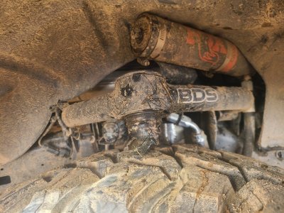

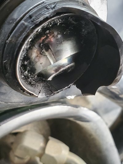

I have the same setup on my 4th gen ram. I also had an upper ball joint break on the BDS UCA. What they told me was that the ball joints work fine with the lift if you are using the strut spacers. They fully extend before the ball joint runs out of travel. The problem was the fox 2.5 coilovers have more travel and over extend the joint. The told me at the time that they could replace the uppers with the same part (same problem) or if I wanted to wait they were working on a new set with a new specialty high range of motion ball joint. I chose to wait and put the stock uca back on. It took a while, I think some time in 2023 or 2024 my new uca showed up. Got them installed and haven't had a problem since.
