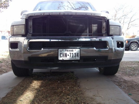

then, i hater the faded plastic on the front bumper. It sagged and looked like an old man truck, so a buddy of mine, who is a Dodge dealership mechanic, gave me a take off front bumper from a 2013 Dodge Ram 3500. so i built new bumper mounts and got that sucker on.
i also added a painted sport grill to fill in the new gap created by the 4th gen front bumper.

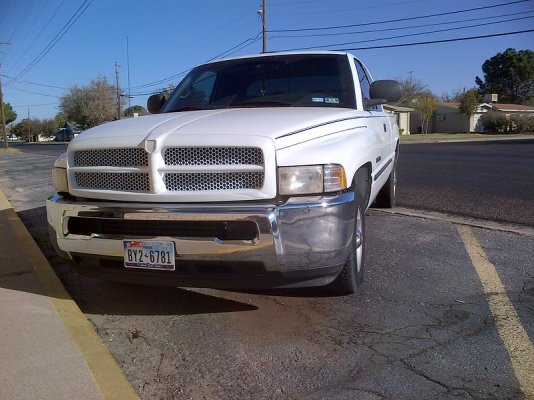

after that, it got a pretty nice booboo one morning in a meeting with a light pole, thanks to icy roads.
so new bumper, new grill. and this time i went a little different.

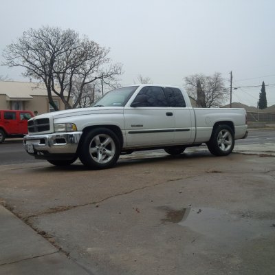

I drove it like that for a couple years, and decided it needed more low. However, since the 01 is a ******* year for Ram's i had to piece and part, and get inventive to bring it back down to earth. Since out city has horribly maintained roads, i cant lay frame, what a coincidence, i also dont have that kind of money. so i went with a simple 2-4 drop.
i also added a 30" light bar to the front grill opening, and have 4 4x4 led pods to add to the fog light holes, but havent got that one finished up just yet.
i went with Western Chassis 2" drop springs out front, and 2" drop shackles out back, and flipping the front leaf spring hangers over, giving me the other 2" of rear drop. As well as a new set of nitro drop shocks to keep me from bouncing around.
i had to chop a couple inches out of the rear bump stops, because i kept bottoming out as well. sawsall to the rescue.

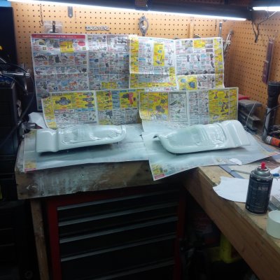

well, yesterday, i broke out the hammer and dolly and got the largest part of the squished bed corner back into place. i shot some paint on it to hold off rust and make it shiny till i can pick up a DA sander and add a little filler, and make it smooth and perfect.
