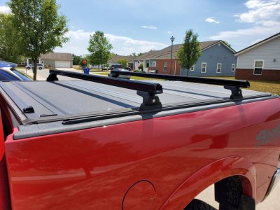

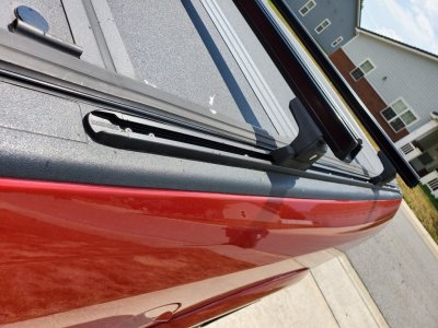

I installed rhino rack rails on the bedside recently. I am waiting for a few pieces for it to be complete but I can post up some pics of what it looks like now.
I have it mounted above my Bakflip G2. I will warn you that I had to drill a number of holes into the bedside to make it work though.

Here is what I have currently. I am waiting for my rack platform to arrive as well as my bike rack.20200701_153056.jpg 20200701_153059.jpg
