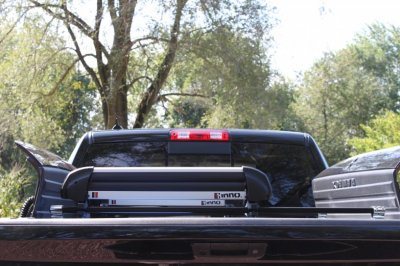

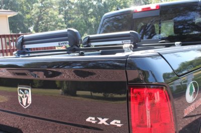

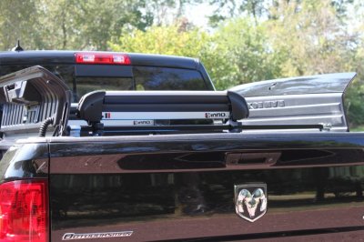

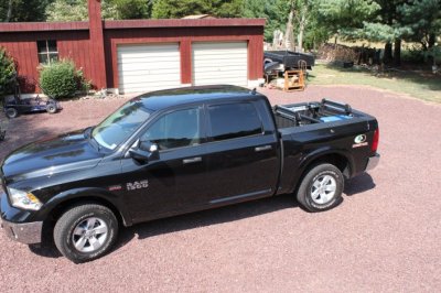

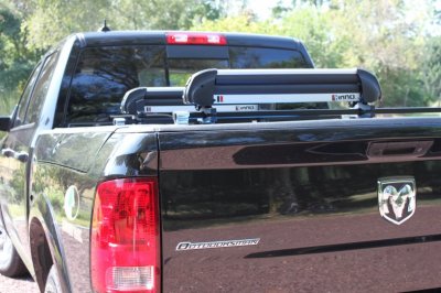

I have been looking for some Bed Racks for my 2015 RAM 1500 Outdoorsman with RAM Boxes, but had a lot of trouble finding bars that will work. Even Mopar doesn't make a kit for the 2015 model with RamBoxes, yet. So I did a small mod on Inno Truck Stays and they fit perfect.
I reversed the direction of the Truck Stays and the Stay Plate. Drilled a Centering hole in the Stay Plate. Because the Bars were flush with the Stays I couldn't fit the Inno Rubber End Caps over the bars so instead I capped the Bars with Plastic Plugs from Essentra Components.
