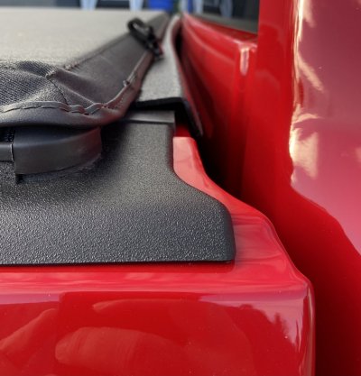

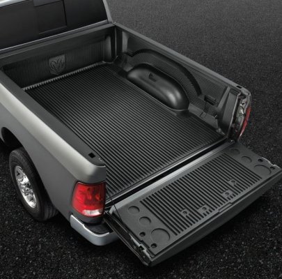

95B7998B-7989-45D4-88FD-EF1538DF1356.jpegMy bedliner should be fitting like in the pic up there behind the cab.

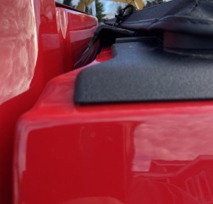

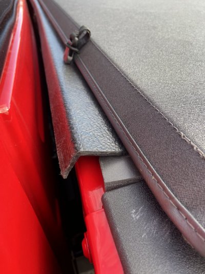

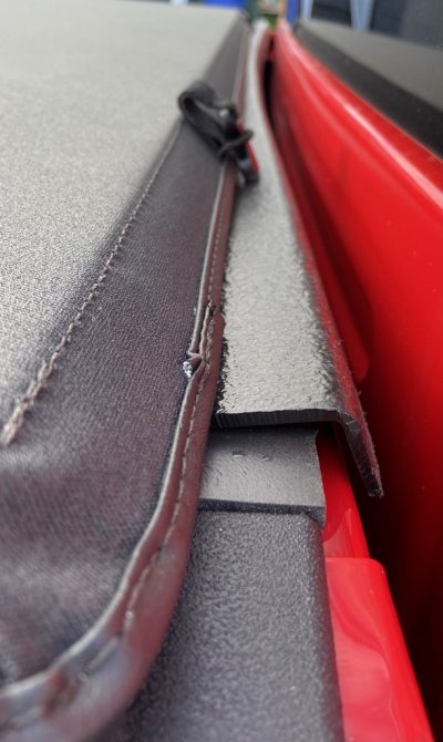

But my bedliner and box cover was installed like in the pics below by my dealer. Every other bedliner on other pickups that i looked at is fitting way better than that. I dont think that i can trust them to do better if they had no shame to sell it to me like that. This is my first new pickup and i wonder what i could do to fix that...2BA3FEA7-A49D-46D4-BB6C-97209F5735AC.jpegA521848F-4E01-4DEE-B667-9B64519AD1F6.jpeg1536DD1D-7E1A-4C88-BBA4-E3442AFCDFCB.jpeg444BB124-CFD3-4630-91EB-4D95ED13CD0B.jpeg96BD39ED-23DF-4A39-A8D8-4EA2D6BFE8F5.jpeg

You can try a heat gun and bend it over a piece of lumber to re-define the shape.

It looks like you have an extra piece of material (Foam?) under the bedliner lip. It's not allowing the lip on the liner to lay flat. If you want to protect that area from wear just get a strip of plastic protective film PPF and replace the foam. My factory bedliner lays dead flat over the front rail just like your picture. If it doesn't go flat the lip is distorted and the dealer should deal with that issue.

I agree with what you're saying about the extra piece, possibly foam. It almost looks like "foam" was put down first but should have been placed on top of the bedliner if it was being done to help seal the cover.
That definitely needs fixed and hopefully it hasn't already damaged the paint on the cab.
