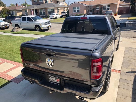

BedRug is in and looks fantastic...now. I’m super pleased with how it turned out. Tailgate gap material folds up and out of the way every time I close it, so I guess the engineers at BedRug know what they’re doing[emoji3].
Also installed my BAKFlip MX4 and went on without a hitch and operates superbly with the BedRug.
Twinning!
