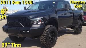

I'm looking for any advice/photos of what people have in terms of a beefy after market front bumper for a 4th gen 1500. Prefer something that bolts on and is compatible with a 3" PA body lift...
lets see those after market front bumpers!

Pretty certain addictive desert design has one they are a sponsor on the forum.

Most bumper replacements will require you to fab mounts for the 3" body lift. I looked into Kore, A.D.D. And a few others all neededing custom fabed mounts.

^it says 6" lift I guessing that is a suspension lift so the bumper goes up with it.
With a body lift the bumpers will need to be fabbed up.
