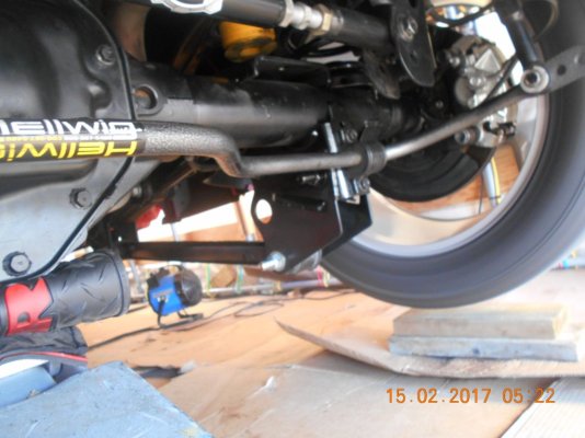

Ryan / Illicit quit making his brackets. I have his brackets on my truck,and i tacked them in place so they wouldn't move. The easiest way to install the brackets is to basically remove the housing,it's easier to cut off the upper brackets and to line up both sides of the new brackets. You can see how they move the lower arm down to where it actually pushes the frame straight ahead,and how they force the rear tires into the ground by promoting body seperation. You want the rear of the truck to rise on launch,so it forces the tires down
